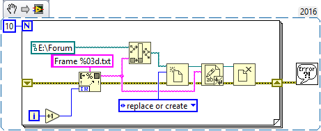

You tried "too hard".  Make the Folder a constant, only build the file name, like this:
