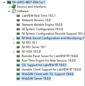

Did you install all the software needed to allow WebDAV on the sbRIO? You can do so in MAX when setting up software installation for the sbRIO…
 I believe I did install all the software required to support WebDAV on the sbRIO. Below is a snapshot from the list:
this is identical to software list I have installed on myRIO which works just fine.

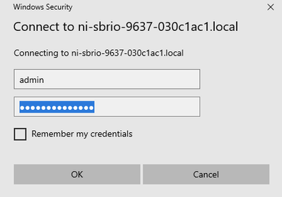

Also, something that I observed, when attempting to add sbRIO as mapped network drive, it give out a strange auto populated password (auto highlighted) and user name section (snapshot below)
sbRIO-9637 (Connected using Ethernet)
myRIO (Connected using USB)

I found out why I could not add sbRIO as Mapped Network Drive:
For some reason not all users had permission: (only administrator had permission)
Save the changes and now I can add sbRIO as mapped network drive.
