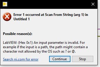

hello i got an error at scan from string , error 85  ,
this is my program , please give me solution

First, your subject says error 85, but your picture says error 1.
Please be accurate in describing the problem.
That and we can't provide a solution.  You haven't given enough information.
Thank you for providing an actual VI to go along with the picture of your code.
But the problem is in the data you get form the VISA Read and are feeding into the scan from string.  That doesn't show in your picture.
If you placed an indicator on that string, and even better, ran your code and saved the data in that indicator as default before saving it and attaching the VI, we could see what is wrong with your data.
Also, your first embedded picture is broken.

If you got Error 1, that means you got an empty string from your VISA Read (ie the read failed either due to an error or timed out).
Error 85 indicates that you got something from the VISA Read, but it does not match the format you state in the Scan From String.  So we are back to "What did the VISA Read output"?
