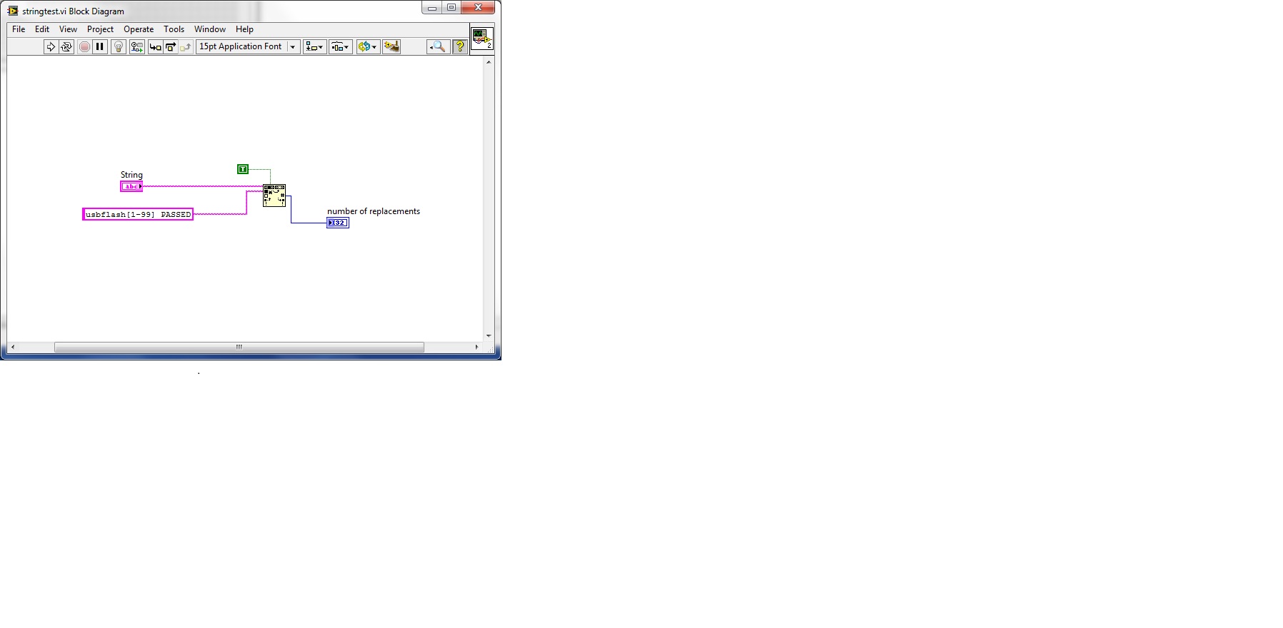

I don't know why it's not working to upload ether ,zip or a vi?
I uploaded 2 images for the front panel and block diagram. Hope you can read it!

Right click on the Search And Replace String function.  There is an option to use Regular Expressions.  Then give this a try.
EDIT: You will need to set the Replace All input to TRUE.

Thank you crossrulz!
I had it set as regular expression - it was the plus sign that was missing.
