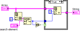

Whoever can help, I have a 2D array from txt file which have many rows and 5 column and I want to do a search and display the other column results.
Eg.
Column 0                      1                           2                                  3                           4
12345                      qwer                       asdf                            12qwe                      tjhrtyert
23568                      werr                        wef                             fgertge                     fsefff
If I manage to search 12345 and I want to display 12qwe, what should I do in labview? Please help!

Use the Index Array to get column 0, use the Search 1D Array to find the index element, use the index element to get the value in column 3.
