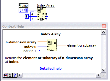

If instead you want to extract certain data bytes from each message, you should use the 'Index Array' function from the Array palette.
This will extract individual elements from the array as specified by the connected Index inputs. The image below shows the setup needed to get the elements for your First Frame.
