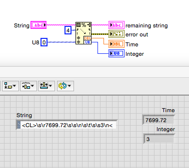

I was hoping to get some advice about how I might search the following string and convert to a real number or integer.  The following data is output as ascii characters from a device and I would like to search for the times in each line (starting with 7699.72 seconds in this case) and convert each to a real number.  Alternatively, I would like to search for the integer values in each line (0 but could be 1,2,10,12, etc) and convert to an 8 bit integer.  I think using the Match Pattern followed by Scan from String VIs would be what I need but am not quite sure how to match in each case. Thanks!!
<CL>  7699.72       0
<CL>  7699.74       0
<CL>  7699.76       0
<CL>  7699.78       0

What characters are in the white space between the <CL> and the numbers?
Scan From String can probably do what you want.  Note that in the image whitespace characters include spaces, carriage returns, line feeds, and tabs.
Lynn

I am fairly sure those are spaces.  Appears I made things way more complicated than necessary.  Thank you.
