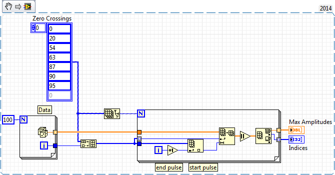

Sounds like you have most of the logic down in your head. This will get you most of the way there, but you have to put in your own data and zero crossings. It will give you the peak between each zero crossing. So if you put in 10 crossings, you'll get 9 peaks back, I hope this is what you expect.
Just a bit off there Gregory
Try a bit simpler solution since the number of "Crossings" is discoverable
Message 5 of 9
(5,816 Views)
Nice Jeff, I like the For loop. When you say "off" do you mean "more complex than it needed to be" or "not giving a correct result"?
Jeff, I think you are missing a Subtract right before the Array Subset since the bottom input is supposed to be a Length and not and final index.
Yes Tim, Thanks.  I rushed.
@ Gregory that "off" was looking at two issues.  1 if no zero crossings are seen the while loop is a poor choice (You get a array of[0] out vice the correct empty array) a for loop is the only way to solve that.   2 the abs val serves no purpose there (but probably does for the case where there are zero crossings in the data) better to abs val the array once outside the loop rather than abs val each chunk.
Spoiler
Just being thourough- it was some nice code with an edge case that could blow-up
