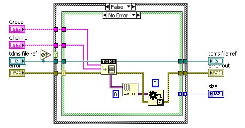

You can read the number of groups, channels per group, and size of the channel from the TDMS file (use the "get property" primitive) to set your sliders' min / max property.
Then depending on the slider's value load just the chunk of data you need to plot.
One issue might be the fact that while the slider is being moved it generates "value change" events continuously.. that can be annoying sometimes.
If you have trouble coding this, let me know where you're stuck.
Hope this helps
PS : here's how to get channel size without loading the whole data.
