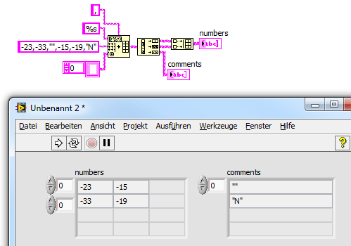

Having a comma as delimiter char used in general would make it quite easy:
(Just to give an idea. Apply conversion from string to numbers, transposing the numeric array, and stripping of the quotation marks on your own.)

Suggestion:
Separate the strings by the comma delimiters.
Then check each string for quotation marks to separate number and comment…

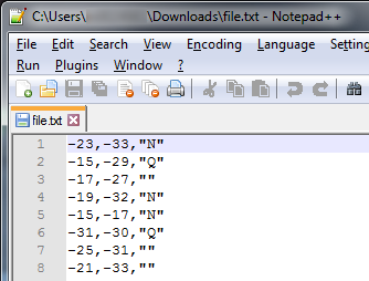

I'm sorry, I forgot. I added an example. I hope it worked.
Br,
Bianca

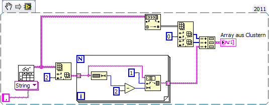

Hi Bianca,
your problem is so easy to solve because there are Linebreaks in the text! You should have posted that example much earlier - and you should have used a real text editor like Notepad++:
Suggestion:
- Read the text as spreadsheet with a comma delimiter
- convert the first two columns to numbers
- strip the quotation marks from third column items (you may use any RegEx/MatchPattern you like instead of my approach)
- build an array of cluster with all the information…
