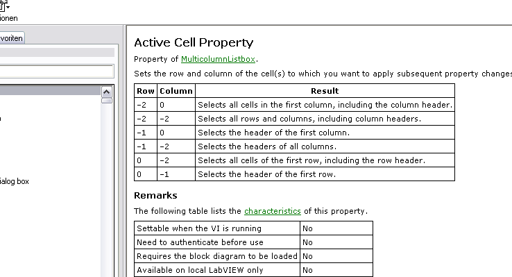

Becktho - thanks for the great tip!   -2?  Where did you pick _that_ up?
I entered (-2,-2) - nothing,  (until you cover the list-box with another window....)

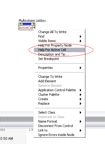

That's from the property's help file. Just right click the property and select "help for ..." in the context menu and the appropriate help window opens.
Thomas
