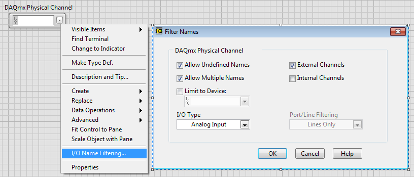

i'am working with labview 2013 and I would like to select on the front panel one or several task of input analog measure, i know how to do with one task but i don't know how to do with multiple task, could i merge two task in one?

What exactly do you mean by multiple tasks? All analog inputs (for example) would be a single task. You can merge multiple channels into a single task. No merging is required if the analog inputs are setup the same.

Some channels are associated with a device (for example Ai0:6 to device 1 and Ai7:10 to device 2) and i want to have the possibility to select what device i want to "measure" by selecting it very simply on the front panel (for example with a single/multiple task selection system)

A Boolean wired to a select function will permit switching between 2 different physical channel controls.

The task i'am talking about is the task of the DAQ function "create a virtual channel".

That's what I assumed when I suggested the select function.

yes i think i could do what i want with this solution, i just had difficultie to find the select function (beginner with labview)
