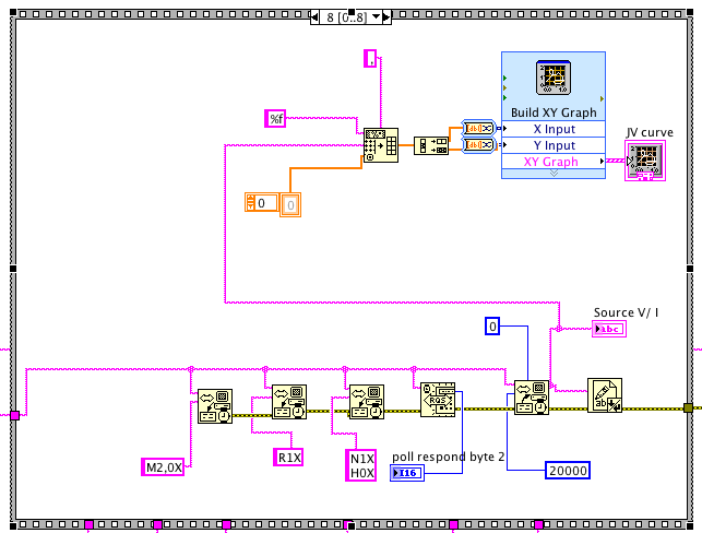

I think this is what you're asking about:
I have the data sent to external file and that seems to work fine. I also tried to have the graph block outside of the block and that didn't work either
r.
this is a sample of the output file:
+0.0000E+00,+02.0197E-09,+0.0630E+00,+0.63524E-06,+0.1260E+00,+01.2701E-06,+0.1890E+00,+01.8926E-06,+0.2520E+00,+02.5222E-06,+0.3150E+00,+03.1609E-06,+0.3780E+00,+03.7841E-06,+0.4410E+00,+04.4131E-06,+0.5040E+00,+05.0510E-06,+0.5670E+00,+05.6749E-06,+0.6300E+00,+06.3032E-06,+0.6930E
Message 9 of 13
(6,022 Views)
That is not what I asked for. You have absolutely nothing in the front panel indicator so you did not set defaults and save. I suspect you are only getting a single pair but because you did not do as I asked, I can't prove it. You also are resetting the XY graph each time and I also told you to change that. Immediately go to the help menu and select 'Show Context Help' and then use it to see where the reset input is. Then wire up a false constant to it.
Message 10 of 13
