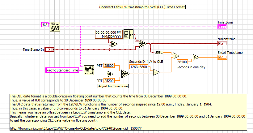

Do it like this, do not just write the LabVIEW time string to Excel in a string array. You will be sorry sometime down the road when you find you can not format  the time column in your data file.
You may have to adjust the conversion for your time zone.
Don't be confused by the results (a strange looking number) that is what an unformatted time stamp looks like.
You can use Excel to format the column into any Excel time or date format.
