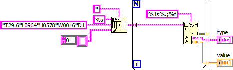

Hi abhi,
convert your strings more carefully!
One possible solution might be:
(4,347 Views)

If the values are showing on the indicators but they are not changing, it is because you are looking at the first line of the concatenated string ever time the loop runs.  You never look at the second or third line.
aputman
