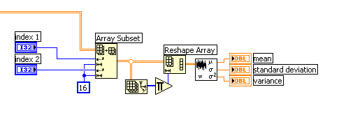

"Reshape" is probably not the right tool here, since you probably want an arbitrary subset.
Use "array subset" anchored at the desired 2D index to get a 16x16 subarray (for example).
Now you still need to reshape it to a 1D array because the "Mean|standard_deviation|variance" tool from the statistics palete only accepts 1D arrays.
See image. Your big 2D array enters from the left.
You should be able to e.g. incorporate this inside two FOR loops to  generate all possible 16x16 subarrays.
