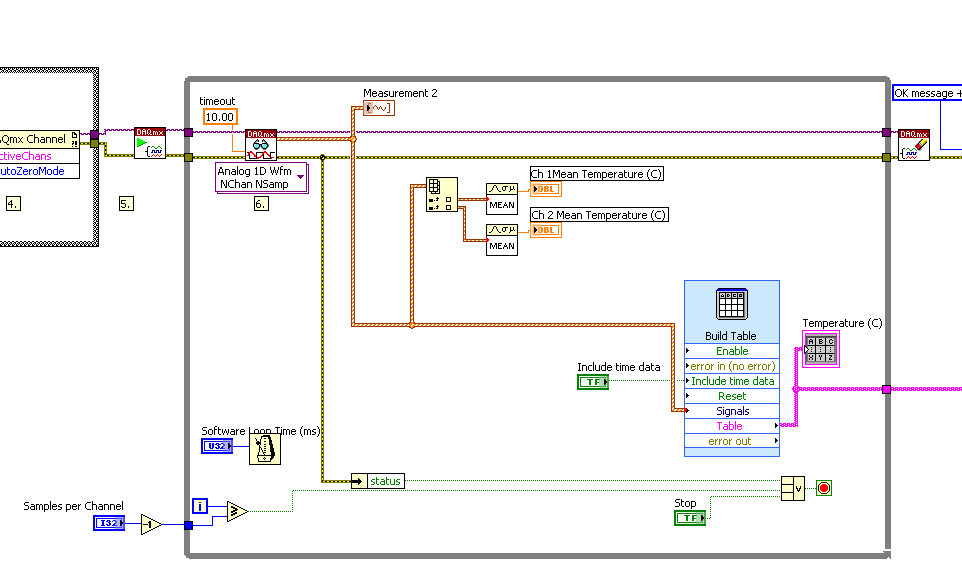

Is there a way to separate data when using multiple channels?  I am running a thermocouple set-up and I want to run 5 channels with their own mean averages, is this possible?  Can I connect tasks to certaib physical channels?  Thanks.

Of course this is possible. All you need is the Split Signal function.

I know I sound stupid, but how do I connect the Split Signal function to the physical channels?  Do I connect it after my create channel vi?

You've got a merge signal and not a split signal and you would connect it to the signal output. That means, that you connect it where you have that merge signal. Since you are acquiring an array of waveforms, the other way to do is to put a single Index Array function on the output. Look at the cleaned up version below.
