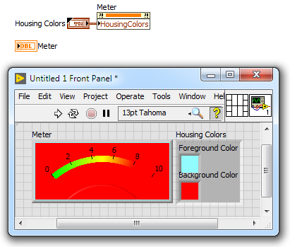

Hi weschen,
the meter control also provides properties to set FG and BG colors:
(2,458 Views)

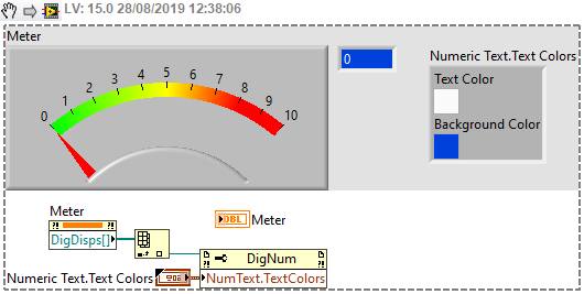

I means the meter digital display control(BG-blue,FG-white).
(2,434 Views)
Accepted by topic author weschen
If you scroll to near the bottom of the property node list, you should be able to find a category for the digital display properties.
You'll find the options you need for color there.
The links from this link Digital Display may be helpful (see the text properties link and the class information
Numeric Text Properties for the MeterNumeric Text Properties for the Meter
Note in the example above, the Meter's "Digital Displays[]" returns an array of references. I use Index Array to get the first (and only) reference and then manipulate that reference.
