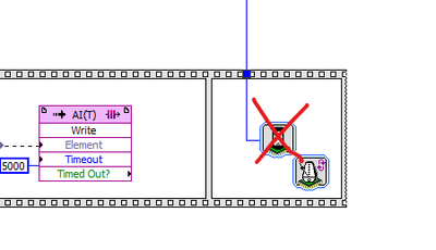

For your FPGA one port.vi:
Do not use the Wait-VI, if you want to achieve a given sample rate; Use the Loop-Timer:
Otherwise the timing needed for the FPGA I/O node, the Write-FIFO and the while loop (that will be two additional ticks) will be added on top of your wait vi.
For two channels, just expand this one-port vi (but again with the loop-timer !!! And exactly like this, inside a flat sequence) to reading two AI from one FPGA I/O node.
Regards, Jens
