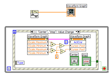

Here's a simple example (LV 8.0) showing how you can center the cursor with a button press.

If some is looking for centering XY graph cursor programmatically, in LabView 2K12 it is possible to do this with locked cursors too.
There is a difference between setting XY position through property node and setting X and Y like in altenbachs example, that will result in moving the cursor to closest last set scale e.g. X or Y like the above case.
To deal with it, just set it directly through cluster as it uses 2D search instead of 1D.
