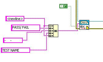

Is there a way to format text in HTML files that are output from Labview?
I am trying to make a report and find that setting up strings with the concatenate (even tabs and spaces) doesn't seem
to be very WYSIWYG...
For example, I have the following VI that I have tried with spaces and tab tokens with no success to set my text output
to a nice format. The concatenate seems to trim spaces even in the middle of the field as the following line is printed like
this:
PASS/ FAIL- -TEST NAME  where I would expect it to be more like:   PASS/ FAIL-     -TEST NAME
I have also tried the "Set The Report tab Width" feature and this doesn't seem to set the tabs when I use the tab tokens in place of the spaces shown in my VI.
Any suggestions?

In HTML, multiple spaces is interpreted as one space.
Use   as one space character.
(3,424 Views)
Thanks-
Is there a way to specify more than one or do I need to feed 4 of these into the concatenate to produce 4 spaces on the HTML output?
(3,418 Views)
Yes, you need to string 2 of the   together to get 4 spaces =  space +   +   + space
