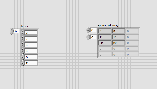

Actually I am testing it, and it is not quite doing what it should, but it is close.  Here is the code if you could give me a hint on what I did wrong.

Turn on Highlight Execution (the light bulb on the block diagram toolbar) and watch what the VI does.
Expand the appended array on the front panel. Is that what you want? It is the result of autoindexing at the output tunnels of the for loop.
Reading the Array indicator and indexing the six values out on multiple iterations of the loop when it does not change between iterations is useless and redundant.
Look up "uninitialized shift register" in the Help.
