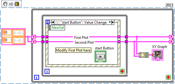

I absolutely agree with Altenbach that you need to learn more LabVIEW, and think more about Design and Style.  I endorse taking the on-line tutorials, paying particular attention to the form and format of the examples that they illustrate.  Try to emulate their simplicity.
However, in an effort to get you on the right track, here is what I was trying to get you to do in my earlier post.Eigens.png
The Event structure is contained within a While Loop that builds and displays the Graph.  The job of the Event structure is (among other things) to generate the data for the First Plot or for the Second Plot when a button is pushed.  The data are carried on the two shift registers shown here, and are combined to make the plot.  They are initialized to empty arrays outside the loop.  Notice that the Boolean Control that "controls" the Event is located inside the Event loop -- when you take the Tutorial that covers Event structures, you will learn why this is done (I also mentioned this in my previous post).
Altenbach is right -- you do not need two Shift registers, as you could do the Array build/updates inside the Event.  "You Pays Your Money and You Takes Your Choice" -- I thought doing it this way was easier to state, and hoped that you would "get it" more quickly.
Bob Schor
