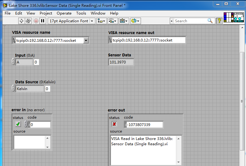

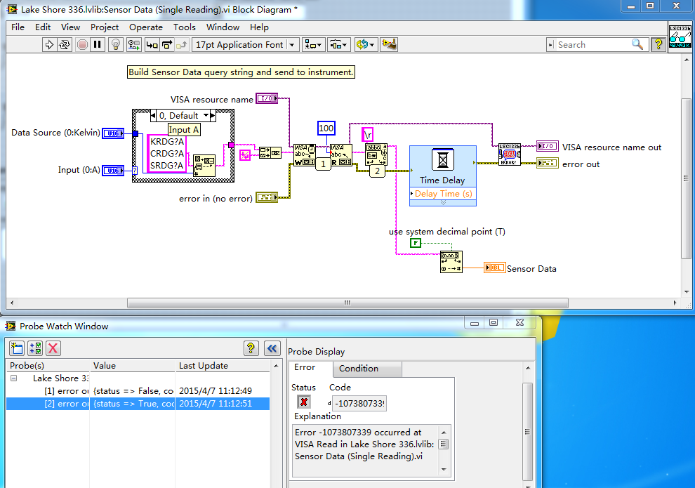

Attached are the snapshots of the front panel and block diagram (with 2 probes) of the VI reading LS336 sensor.
There are 2 probes inserted. One is right after VISA Write, which shows no error; the other one is right after VISA Read, which shows error. But strangely,  the VI still acquires the sensor readings correctly even the error occurs.
Thanks in advance.

By several days trials, I found the reason.
The byte count set to the VISA read function have be to equal or less than the return bytes by the instruments. Otherwise, timeout (slow response) happens.
I don't understand why VISA-TCP/IP cannot work like VISA-GPIB which can automatic accept the returned bytes no matter how many byte count I set to the VISA read function.
