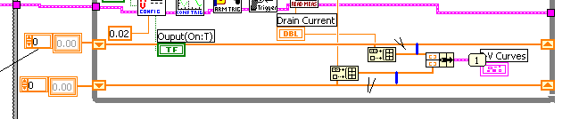

I am trying to use shift register to create two arrays (current and voltage) during a voltage sweep. The two arrays are subsequently bundled to display in XY graph. But I found it can't display the curve in real time. And I found the reason is that the two shift registers outside of the for loop do not update as usually. I am confused with the situation. In this case, the for loop is inside of a sequence structure, inside of another for loop. Please see my attachment for the diagram. Hope to get some help here. Thanks.

As far as I can see, you're doing nothing to update the value of the shift register. Also, having those 0 constants will erase any value in the shift register every time the outside while loop runs.

Novatron beat me to the answer. He's correct - you're not writing anything to the shift register. Also, please don't post .bmp files. they take way to long to download. Post a jpg, gif, or png. Paint is capable of saving all of these types.

Most likely, what you want is shown in the attached image:
Break the wires at the black lines indicated (||)and connect where indicated with a blue line.

Thank you Novatron, Dennis and altenbach. There was a mistake in my wire connections. Now it works perfect. Attached is my new wiring. There is no problem to use zero value at the beginning of each loop. Do you guys use screen print to save diamgram into jpg or other file format? I am wondering whether or not Labview can do that too. Thanks.
