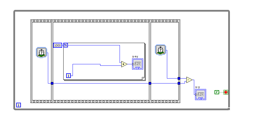

i try to caclute number of clock for this example to caculate the delay for the """for loop with 1000 itration""

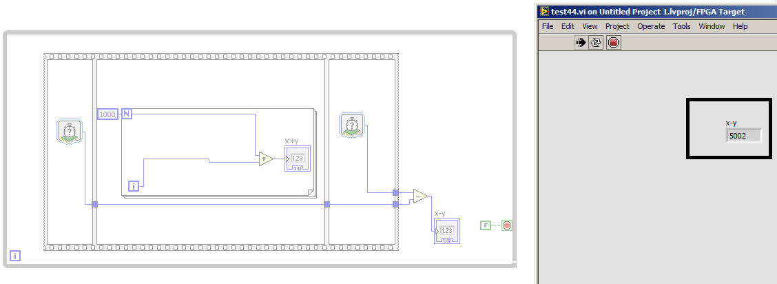

after the complition process the vi was excuted on fpga and read the tick count in pc with real time  and the number of clock was  as shown below 5002 clock
what is this ???
is thier any wrong in my vi

What's the problem? It took 5002 clock cycles, which is probably 5 clock cycles per for loop iteration plus 2 cycles of overhead. What did you expect?
If you want one clock cycle per for loop iteration, then you need to use a single-cycle timed loop instead of the for loop.
EDIT: that's assuming that you have the Tick Count VI configured for clock ticks, not milliseconds or microseconds.
