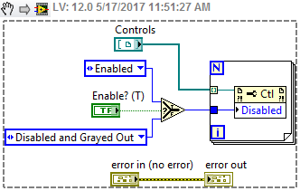

Pass the array of references to a subVI and enable/disable them there, so that the code can be reused.  I don't use the disabled option because IMO, it's not disabled unless it's grayed out.  But that is a personal preference.
