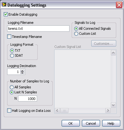

You say that your ultimate plan is to take one time step worth of data and send it to a motion controller. If you want to get deterministic behavior in that system, you'll need to run your simulation on real-time hardware, by building a DLL out of your Simulink model. If you don't need deterministic behavior, then you have a couple of choices. If you're still interested in writing all the data to a file, then you could change the SIT Read Loop so that you call the Dequeue Element function once for each variable you have. Then, you can write a loop that interleaves the values from the queue, so that you get all the samples for one time step written out together. Or, you could use a To File block in your Simulink model, which would write data to a file. Or, you could upgrade to SIT 3.0, which has data logging support built in; it works in the way you're trying to achieve.
Here's what the configuration for SIT 3.0's data logging looks like, to give you an idea of what's possible:
