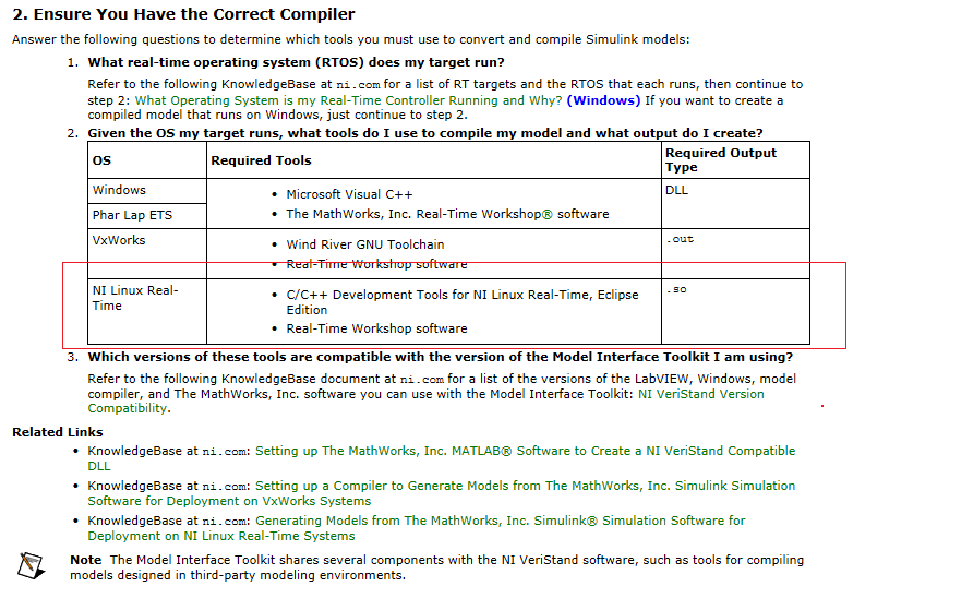

Pic of 2013 just a previous versions install screen form(http://digital.ni.com/public.nsf/allkb/E37B8A669CF7FD2E86257A5B006C6600)

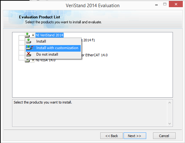

Pic of 2014 is my installation process..........
I want know why the install process different between 2013 & 2014...
I want install 2014 Model Generation...How find it??

I downloaded the 2014 Evaluation installer on my machine and found that you have to choose this option on the main page:

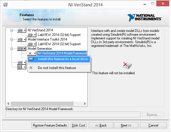

In order for the installation process to show you this page:
Otherwise it just chooses the standard features and doesn't let you include the Model Framework!

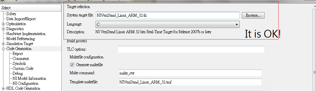

I already install success,in matlab I try build a .so
It response an error...
I had install C/C++ Development Tools for NI Linux Real-Time, Eclipse Edition 2013 that provide by NI
( http://www.ni.com/download/labview-real-time-module-2013/4286/en/  )
