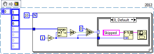

I believe this should do what you are looking for. It will skip the cases as defined by the array.
