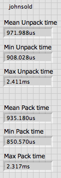

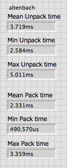

I took your test VI and placed my code inside. I made one other change - I removed the progress slider to be consistent with your code.
When testing I noticed that occasionally your code executes much faster than most other times. So I wrapped your test code in a for loop and calculated minimum, maximum and mean times.  LV 12 SP1. Mac OS X.
My mean times are faster than yours, but occasionally your minimum is much lower than the minimum on mine. (1000 iterations).
These tests are with the default string (from which the "+" was removed).  I have not run them with large datasets.
Test Base64ToSGLArrayandBack.loop.vi has altenbach's code. The version with .L.Loop in the name has my code.
Lynn

Well, not fair, you did not use my V2 posted above. As I said, the parallelization is not worth it and there were too many data copies. I think that also causes the variability in results.
Here are your benchmarks after substituting V2 subVIs. 😉
Seems I am about 4-8x faster on my PC. 😄
