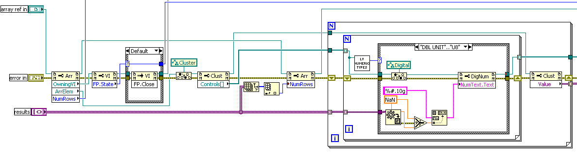

The example code I posted a few posts back includes a VI named data-loader.vi where I loop over a double array of OLE variants that came from an ActiveX/ADO/ODBC call.  As we know the structure of the data in the cluster, in the inner loop we have a case structure where we do a variant to data of the appropriate data type, then format to string, if needed, for e.g. double values, and/or select empty strings if the conversion failed, which it will in case of null variants.  We then stuff that string in the text.text property of the control.
That code runs fine (fast enough) in LV7.1, LV2010, both 32 bits, not so fine (slow or crashes) under LV2011 64 bits.

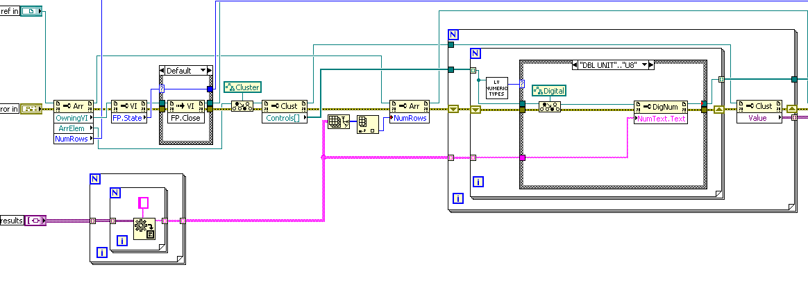

I decided to try adding a double for loop over the variants and do a variant to STRING type data, and when that worked I now only have to feed the strings to the old double loop without having to do a variant to the appropriate data type and/or test for conversion errors.  This works just as well and fast on LV2010 and LV2011, under 4 seconds (under 3 seconds after I optimized a couple  more things in that VI.)
Not sure where 2011 is spending all the time, but I suspect is handling the NULL variants. I'll let NI have fun with it, but it sounds like a bug of some sort.
I'll attach images of the old and new code below.  Spent the whole week tracking this down, installing and uninstalling stuff...

Those images were inline in my browser 🙂  Do they have to be approved or did I do something wrong?  I'll attach them here, rather than inlining.
