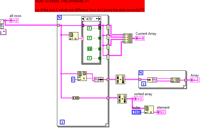

I am attempting to make the case structure dynamic (or if there is another method), whereby if the entries in the first column change, that I can get the correct array output.  In the attached VI, the case structure is hardcoded with the first column data.
In essence, I am trying to sort the array based on the entries in the first column.   Is there a dynamic solution for this?
hiNi.

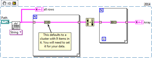

Turn each row of the 2d array into a cluster, resulting in a 1d array of clusters. Sort this array using the 1d sort node, then turn result back into a 2d array. Use loop parallelization when converting to/from cluster.
Mike...
Mike...
Something like this...

Yes, and if all the OP will ever need is sort by the first column it could get even simpler. Auto index the 2d array to get rows, use the array to cluster to convert it into a cluster. The 1d sort node, sorts the array by items in the cluster. Item 0 is the first sort term, item 1 the second and so on.

You're trying to hard. This is what I meant:
Like the note says, the conversion to the cluster defaults to 9 elements. So you may need to reset that. The conversion from cluster to array, doesn't care how may items are in the cluster.

PS: If yiou want the first row to be handled differently, strip it off before you do this...
