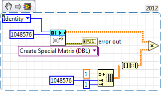

I am trying to utilize the Multicore and Sparse Matrix toolkit to creat an n x n identity matrix with n = 1048576. However, I receive a memory error. Is'nt the purpose of this toolkit to store sparse matrices using memory storage techniques? I would like to premultiply an n x 1 vector by an n x n diagonal matrix. Does anyone have any alternative approaches?

I want to multiply a 1048576 x 1 column vector by 1048576 x 1048576 identity matrix. I am using the special sparse matrix toolkit functions.The identity matrix will have over 1012 elements in it. There is obviously not enough memory on any PC that can store this many elements. However, sparse matrices are typically stored in other programming languages in a certain format that allows extemely large matrices to be used in calculations (i.e. in Mathematica, I can execute this process easily).  Below is the error I am receiving.
Error - 20001 occured ar NI_MASM_BasicLinAlglvlib:Creat Special Matrix (DBL).vi:2
Possible reason(s): Analysis: There is not enough memory to perform the specified routine.

You are using the plain (=non-sparse)  matrix tools (just optimized for multicore).
The create special matrix (sparse) is in the "Sparse Linear Algebra" subpalette. It has a different icon.
Message 7 of 8
(5,491 Views)
Thank you altenbach. I did not notice the subpallette. This seems to be working fine now.
