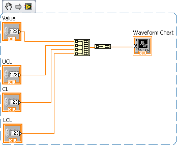

My guess: you only input the UCL,CL,LCL once....
 put them into a two dimensional array and feed this to the chart

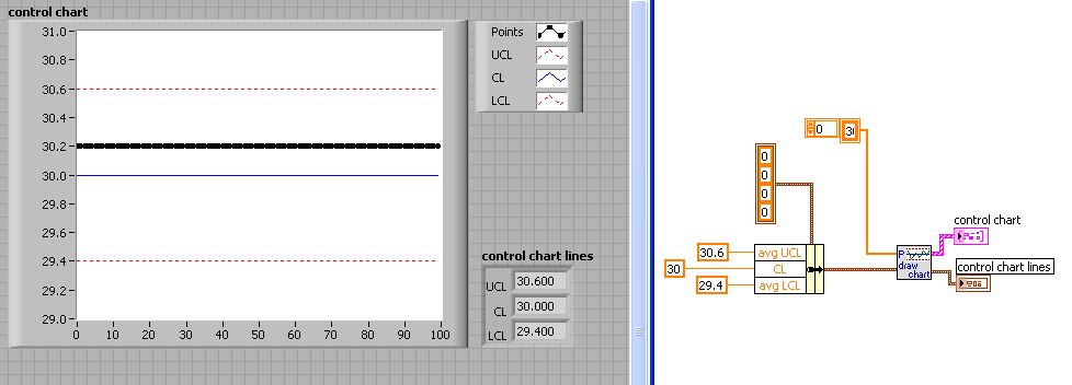

Hi Rik,
I have just had a quick play with this contorl and have had no issues displaying the limits.
I have attached the VI below, have a play and see if this one works.

You my good sir are a legend.  I had simply set this up wrong 🙂
