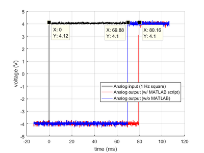

When I simply have the analog input directly routed to the output, there is a ~80 ms delay (with the MATLAB script, ~70 ms without) between the input rising edge and the output rising edge. To perform this test, I put a 1 Hz square wave on my input and measured the analog output relative to this input, as shown below:

First of all, you do not have a cRIO here.  You have a cDAQ system.  There is a huge difference.
Now to your issue.
So you have the DAQ set up to sample at 1kS/s and you are reading 100 samples per loop.  So a single iteration will be 100ms.  Therefore, I would expect a 100ms delay between your input and your output.
What kind of delay are you wanting?  What processing are you wanting to do with the Matlab node?  You may actually need a cRIO to do this properly.
If I, say, decrease my number of samples to 5, the delay is still about 70-80 ms (without MATLAB).  As I said, I've played with the timing sample rate and samples per loop and had very little luck in terms of being able to find the optimal values.  Part of my problem is that there is obviously something here I'm not understanding in terms of timing and buffering.  I'm not an expert in the slightest (hence my misuse of language, etc.) but it does seem that I am hardware limited.  I suppose I just wanted to confirm this.
