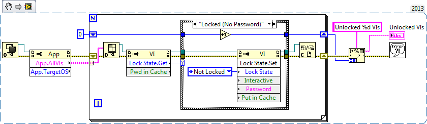

Actually, that wasn't the problem -- I had to open the VI, go to File, go to VI Properties, Protection, and set it to "Unlocked".  I hadn't encountered this before ...
BS
Message 21 of 26
(1,578 Views)
There were 22 locked VIs.  Not wanting to hunt them down and do this "by hand", I whipped up the following VI to do the dirty work.  You need to load the Main VI into memory first ...
Enjoy.
