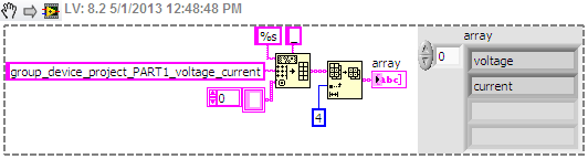

If this is what the text always looks like, you can always take the 5th and 6th elements without worrying about the "x" in Partx:
If it's not that easy, you can use a Regular Expression to find the "Partx":
Match Pattern will work, too.
