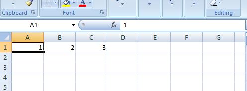

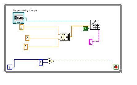

spreadsheet not appending newline
Why does this only give me one line rather than 5?

Hello Erny123,
Your stop logic is inverted- you need to use a greater than rather than a less than operator.  Right now, i=0 is less than 5, so the loop only executes once.
Tom L.
(2,884 Views)
Wow thanks. Been looking at it for half an hour.
(2,880 Views)
Or just click the conditional terminal to make it "continue if true". 😄
Still, since you know the number of iterations before the loop starts, a FOR loop would be the right choice here.
