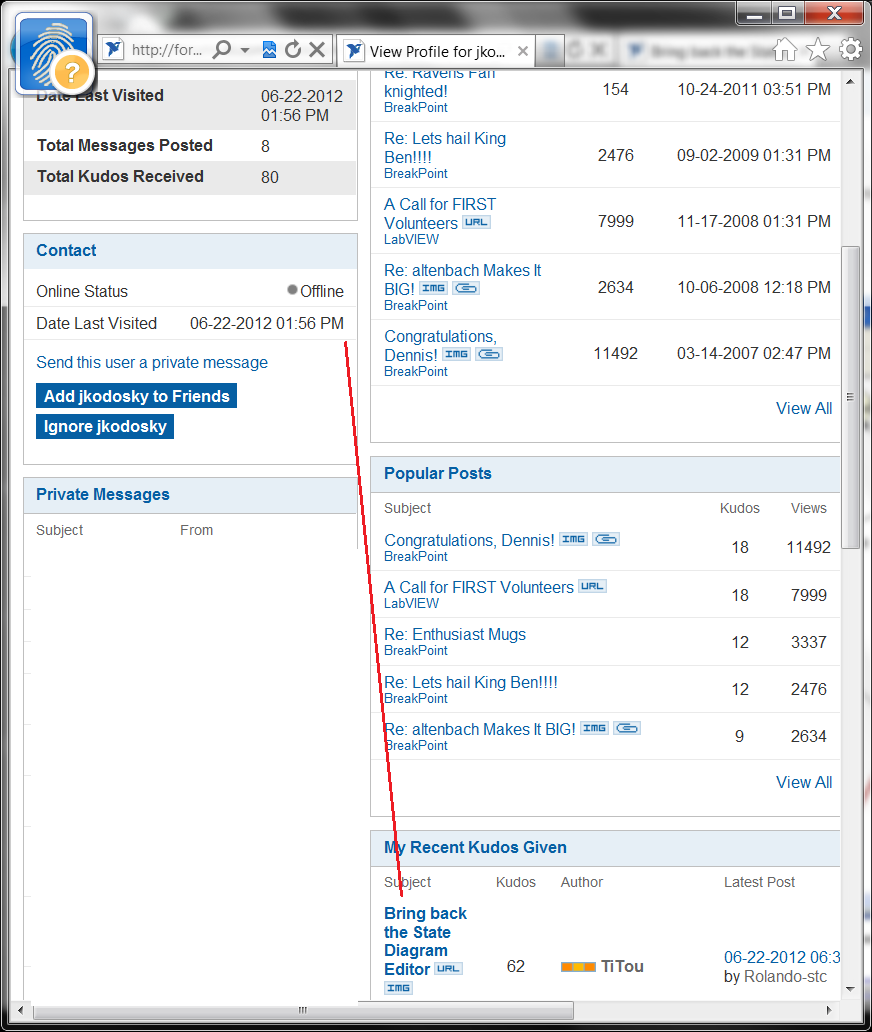

Edit: I should really read all the responses first, I'll see crossrulz beat me to it. I'll add a link to another one for good measure

If it gets Jeff K on our side, I plug all day.
