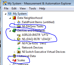

Open MAX on the target PC after the installer runs.
Do Tasks, System devices and Scales match the setting from the development PC?

Ok I got it. After I reset the configuration in MAX and re-installed the installer, I checked MAX, and found that the
NI-DAQmx tasks are the same as they are in my original computer, but under the option 'Device and interfaces' I
see 2 NI 9265! 'Dev 1' and 'Dev 2', one has green icon and one has yellow icon on the left. And it shows that my
PC could communicate successfully with both!
Anyway this time I failed again, after checking MAX only Device part is odd. So any idea?

Hello jcraffael,
The yellow icon indicates that the device is simulated rather than physically present.  You'll need to delete this device and rename the physical device to match the configured task.
