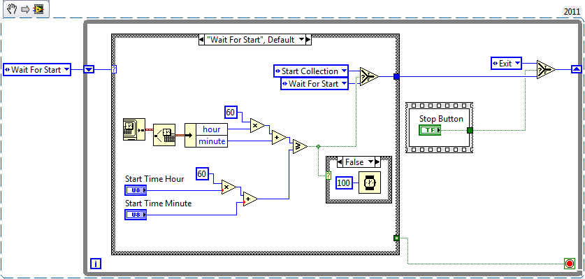

Use a simple state machine. Here is something to get you started. NOTE: The ENUMs used in this code should be a typedef. I did not do that for this simple example.
Mark I have a question for you. I feel there is no difference when we use the Get date/time in seconds or not and the stop button is inside the sequence structure that also I feel no difference if we don't use the structure. Is there any specific reason why you have done in this way? (just trying to understand)
Message 3 of 13
(5,796 Views)
Yes, the Get Time in Seconds is probably not required. The Stop button in the frame is missing a wire. I intended to have the state wire wired to the frame which would force the stop condition to be read after the state execution and not before. As written it would read as soon as the loop iteration starts. If read early it can result in an extra state being executed. I just whipped this up very quickly so it was easy to make a few simple mistakes.

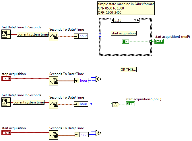

you can also try this.....forgot to include in the text:  OFF-0000 to 0400?     Smiley Sad

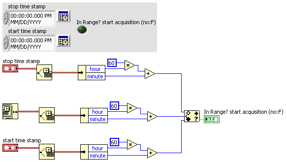

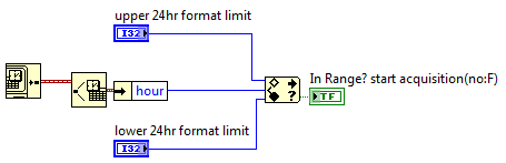

The case structure would not be a very good way to do this since the code would have to be modified in order to change the start and stop times. In addition, none of you solutions allow you to start/stop the system on anything other than on the hour. The comparision above and teh In Range comparision both are workable but should be expanded at least allow the start/stop time to include the minutes.
Implemented in the state machine it makes more sense to have states to explicitly check for the start and stop times rather than a single comparison for all of it. The code is a bit more clear with explicit states.

ok, ok....im just a padawan! btw, take care of your coercion dots....Smiley Wink
