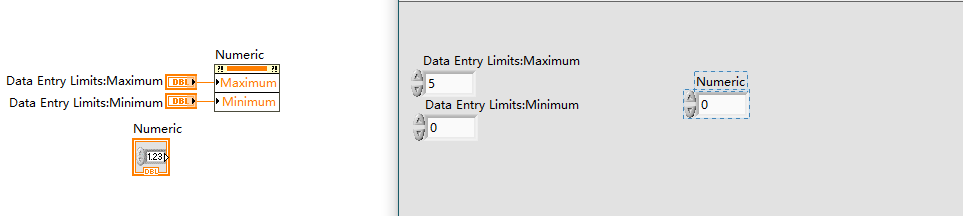

I am working on to create a step size control of fill slide or numeric control. What I have learned on the youtube is that I can set the maximum and minimum values of the control, but it only increases 1 each time. What if I want it to increase by 0.5 or 0.6 or 0.1..... The graph shows what I mentioned above. Basically, my question is that how could I create a control to set the step size of numeric control? Thx!捕获1.PNG

Did you look at the other property nodes available for the control?  The increment value is literally right next to the Max and Min limits.  It seems you would benefit from the free tutorials available on the front page of the LabVIEW forums.

Property node of the numeric control.

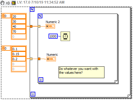

Basically you'd use loops and shift registers.  Considering your list is pretty short, I'd just create an array constant and type them in!  A For Loop inside a For Loop where the outer one provides the "E.L" value and the inner one provides the "D" value.

Yes, you are correct. The picture you post helps me to solve the problem so that allows me to move on to the next question which is 'programmatically create a series of values'.
Do you mind if you can go more detail please?  Confusing.
