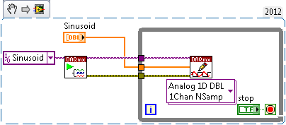

We now have a Task that expects 100 points and will drive the D/A converter at 30KHz, outputting those 100 points until we tell it to stop.  Something like this:
The Orange input labelled "Sinusoid" is an array of Dbl, the sinusoidal waveform you want to output.  The box wired to the input of the Start Task is simply a Task Constant (hover around the upper left corner until the Wiring Tool appears, right click, choose Create Constant, and you'll get an I/O task).  If you now click the downward triangle, you should see the Tasks that MAX has created -- in my case, Sinusoid.  Note this has all of the settings you put in MAX, including voltage range, sampling rate, etc.  So all you need to do is build a While Loop and tell it to output 1 channel, N Samples, and it will do cycle-after-cycle until you say Stop.  Bring the Error line out and close the Task (I left this step out).
Now, I'm home, and I've built this "remotely" at work, so I haven't tested it.  I think, however, that it should work.  Give it a try.
