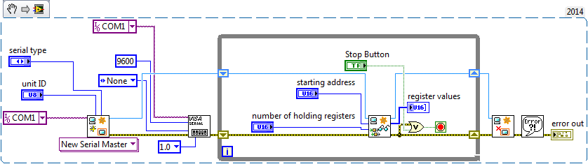

Take a look at this code.
It shows the general idea on how to configure the port to work with a single stop bit instead of 2.

Mike,
After digging into things a bit more, we can remove that code entirely.  The API uses its own version of the configure serial port VI that's a subVI to configure the port to match the type of connection you're using.  Based on the parity you define when setting up the Modbus Master, it will determine how many stop bits are required and configure the port appropriately.  If you choose parity, it will set 1 stop bit (as you're doing).  If you choose no parity, it will use 2 stop bits.  At no time will it set 0 stop bits.

I wouldn't even think it would be possible to have zero stop bits.  When I look at a serial port in Windows device manager, the only options I see are 1, 1.5, and 2 bits.
The code BoKnows posted is one of the newer API's; one I'm not as familiar with.  With the newer API's, you have to use the initialization subVI.  Whether the separate VISA configure works with it or not, I don't know, but I guess it probably would.
I disagree with the statement that the  separate serial configure can be removed entirely.  Probably 99% of the time it can.  But it is wrong for the Initialization subVI to assume the number of stop bits based on parity.  It might just guess wrong.  I know the older modbus library (https://forums.ni.com/t5/Reference-Design-Content/LabVIEW-Modbus-API/ta-p/3524019) assumed the number of stop bits.  As DailyDose said, not all modbus devices follow the standards exactly as they should.  It is very possible that the original poster's problems are based on a device that is not adhering to a standard.
