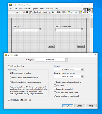

This is what I thought it was, but the vi is not set as re-entrant and I have never set it as a clone as I would not know how.
As it is not set as re-entrant how else can it become a clone.

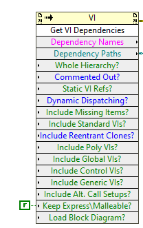

Those are likely calls to .VIM files in that VI.  If you look you will probably find 2 of them in use, which could be 2 of the same one or 1 each of two different ones.
VIMs look like that because each time you put it on a block diagram, it creates a tiny copy of itself that embeds itself onto the block diagram, which is why it looks like a VI has another VI it it.
If you set the "Keep express/malleable?" setting to False, it should go away and you will instead see the VIM in the list.
(1,407 Views)
I was not aware of VIM files and it seems that \i used one without knowing. That VI has a "Is Value Changed" function that now I  see is a VIM.
Thank you. It was annoying not knowing what was happening.
