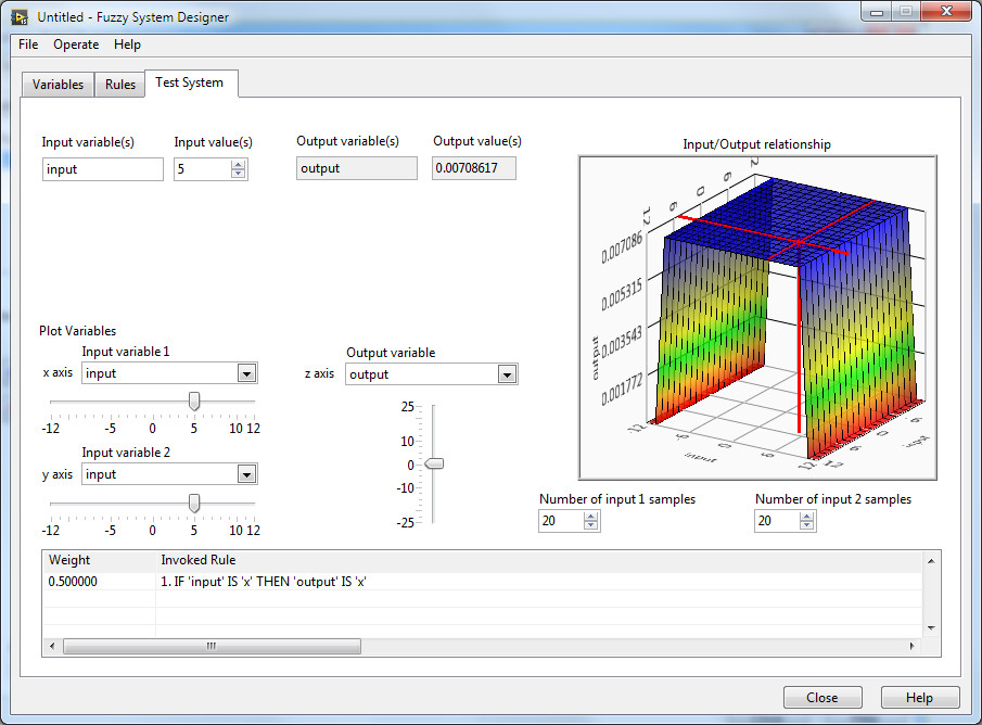

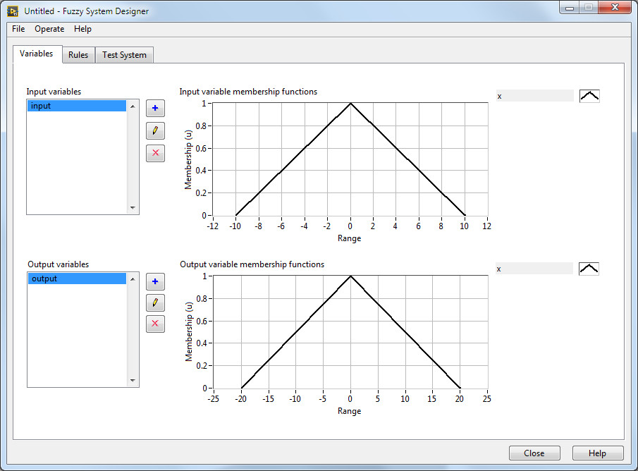

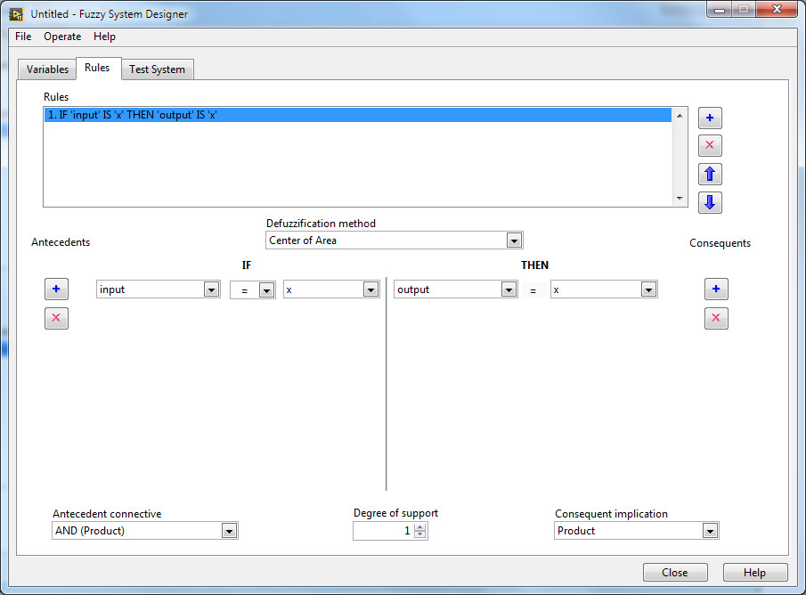

to screenshot below show the single input and output variable and function as well as the result and 'test system'
I would expect to get a linear doubled output compared to the input.
But the 'test system' is showing something entirely different.

I haven't even started making the vi's yet. At this point I am only using the 'fuzzy logic designer' that gets installed along with labview. I have posted the front panels of the designer.
