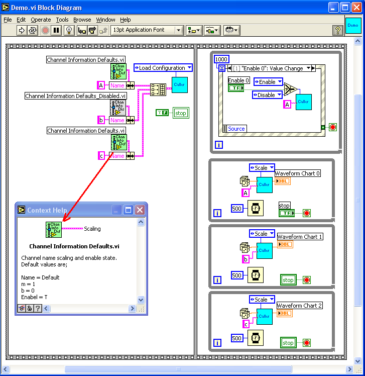

Quoting from My Type Def Nugget from march 2007 in the notes section
*** Type def’s define the data type and not the default values. You cannot use type def’s to establish default values. If you modify a type def that is used as constant on a diagram, all instances of that type def will be replaced with new instances. Default values that were saved in the block diagram will be lost when the constant is replaced with the new definition. This is by design. The method I suggest for establishing a default value is to use a sub-VI to explicitly define the value. In the case of clusters use a bundle by name node to set the fields as required.
Where I have illustrate the use of sub-VI’s to establish default values. In the example, there are two sets of default values of the type definition “Chan Info” (Channel Information) denoted by the green and grayed-out icons.
So...
I do not think it is a bug and is not new.
Frustrating?
Yes.
I use a sub-VI to establish the defaults. It adds another VI to the mix but it allows me to change it in one place instead of chasing down many and it also gives you a little documentation to explain what is what.
