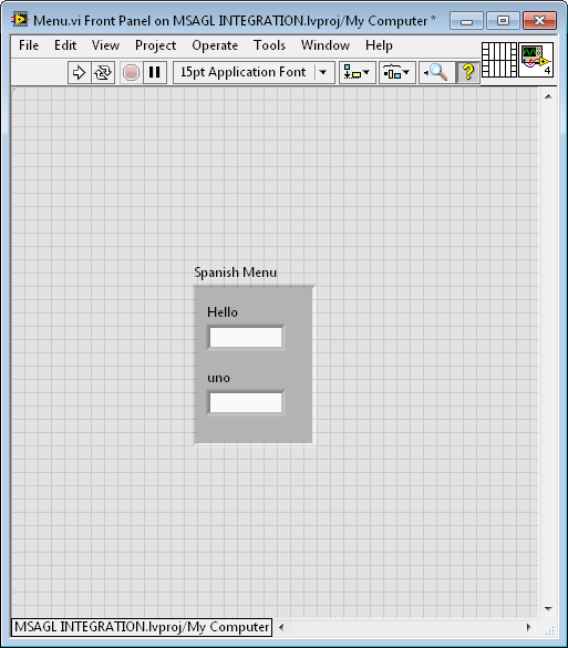

Here you can do something like this before runtime. 🙂
After that use VI scrpting to edit the words.
Then Magically when you open the previous menu.
You'll also notice that i used labels.
Message 7 of 11
