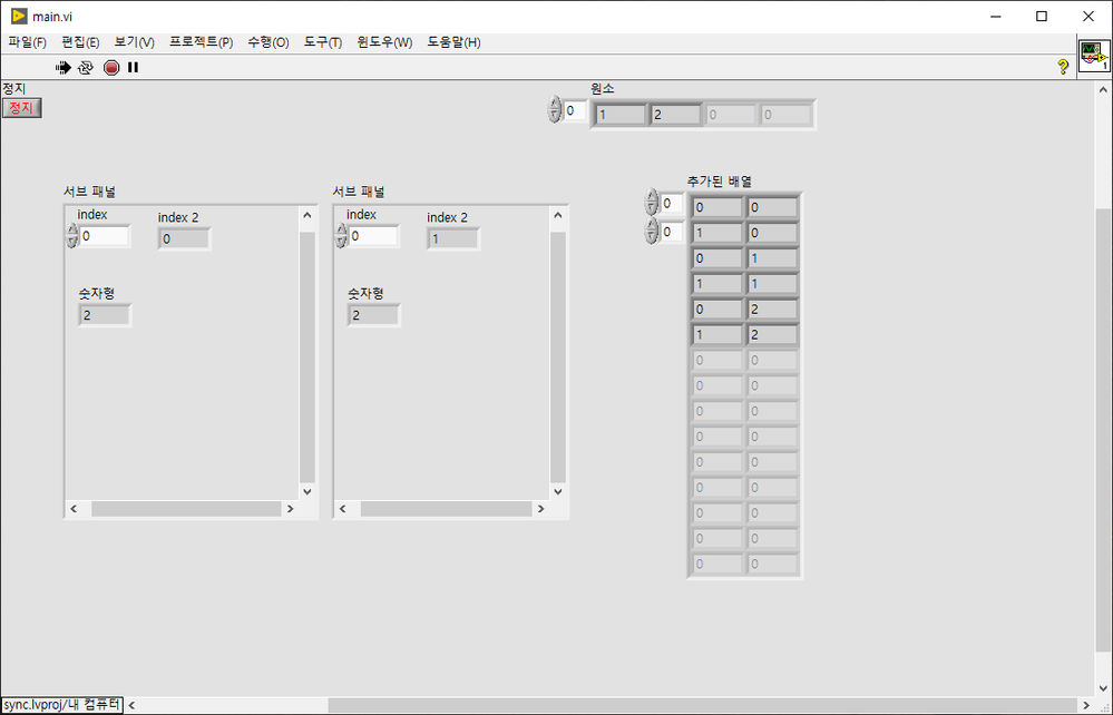

As the title says, I want to duplicate sub.vi in ​​the subpanel and run each one and receive data from the main. More than 50 duplicated subvi will be executed.
When executed in vi state, it runs well as shown below.

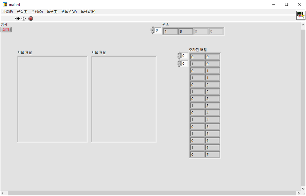

When I create the file as exe and run it, nothing is visible in the subpanel.
The subvi is shown as duplicated and running.
I want to see the subpanel in runtime, but which function did I use incorrectly?

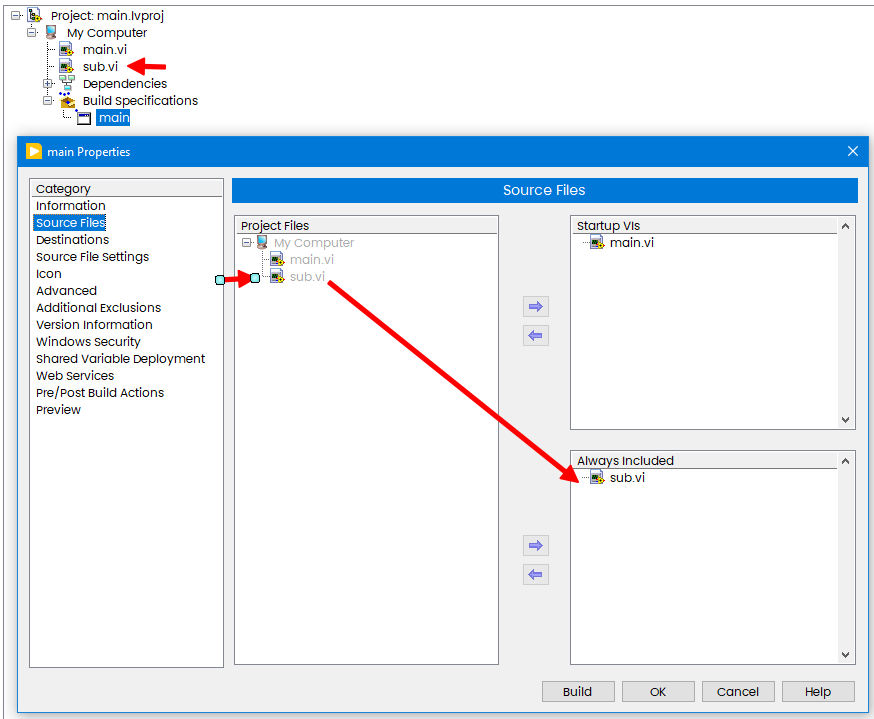

This should help:
